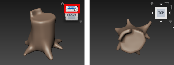

Navigate using the ViewCube
Each region of the ViewCube corresponds to the view of that region of your model. Clicking the top of the ViewCube switches to a top view of your model.
To change the scene view using the ViewCube
  • Place the cursor over the ViewCube and click when the desired region is highlighted.
    For example, from the default Perspective view, you can easily click the top of the ViewCube to switch to a Top camera view.
    Your point of view on the scene changes to match the region of the ViewCube you selected.

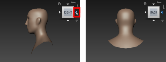

To switch to an adjacent orthographic view
  • Click on any of the four arrows that appear around the ViewCube.
    These arrows represent the views adjacent to the current orthographic view. The orthographic view changes to match the adjacent view you select.

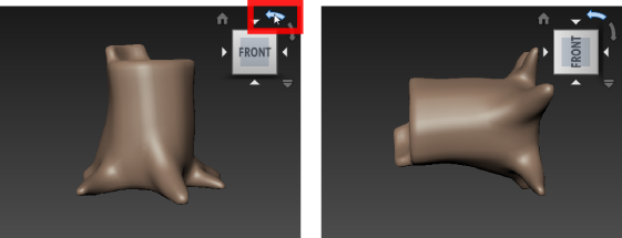

To roll an orthographic view
  • In the desired orthographic view, click on a curved roll arrow to roll the view in either a clockwise or counter-clockwise direction.
