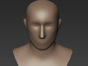

With the Caliper tool, you can measure the exact distance between two points on a model or a curve.
To measure between points on a model
- Select the
Caliper tool
from the
Select/Move Tools Tray.
The cursor displays Caliper tool crosshairs
- Click two points on the model, or click then drag to the second point.
Mudbox displays the two points as small crosshairs
on the mesh. You can drag points
to adjust their position.
The distance between the two points displays as a HUD message. To stop viewing the HUD value, click an empty area off the model.
