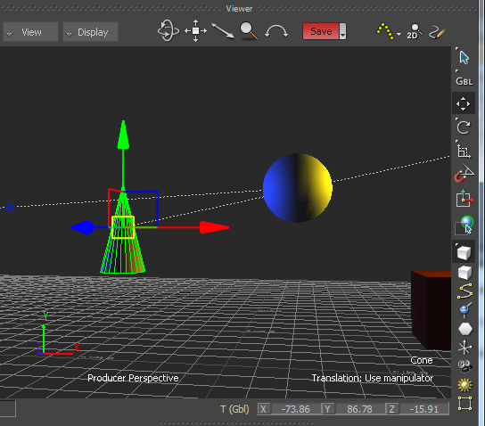

Translate
Select Translate to activate Translation mode and move the selected object according to the Reference mode you have selected.
Translation mode lets you translate objects using the Translation arrows, and by entering values or dragging in the X, Y, and Z fields. For more information about translating objects, see About translation.
You can move multiple objects in their own respective local space using the translation tool. To do so, Local Reference mode must be active.

Rotate
Select Rotate to activate Rotation mode and revolve the selected object according to the Reference mode you have selected.
Rotation mode lets you rotate selected objects using the Rotation rings.
You can also select the Rotate Around option, which lets you designate a single object in a group of selected objects as the manipulation point. To select the Rotate Around option, click and hold the Rotate button to expand the Rotate menu. For more information about rotating objects, see About rotation.
