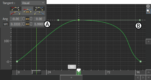

The Weight settings include two fields (B and F in the previous figure,) that allow you to change the weight of the tangents for a selected keyframe.
To change the value in a field, drag in the field, or double-click in the field and type a value. You can also drag the tangent handles themselves. The Weight field on the left affects the left tangent, and the field on the right affects the right tangent.
Changing the weight of a curve A. Weight settings are at 0.333 and 0.990 B. weight of the tangent on the right is changed
