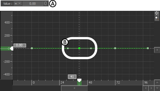

In the following figure, the equals (=) option is selected and 0 (zero) is in the value field. This causes the selected keyframe to appear flat, as shown in the following figure.
A. Value field reflects the selected value of curve B. Selected keyframe in the FCurves pane

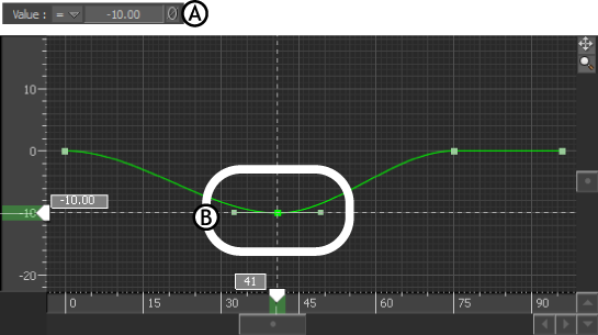

In the following figure, the minus (-) option is selected and 10 is in the Value field. This causes the selected keyframe to make a negative shift from 0 to -10.
A. Negative value shown as a result of selecting “-” as the Value option B. The Selected keyframe changes to the selected value in the FCurves pane

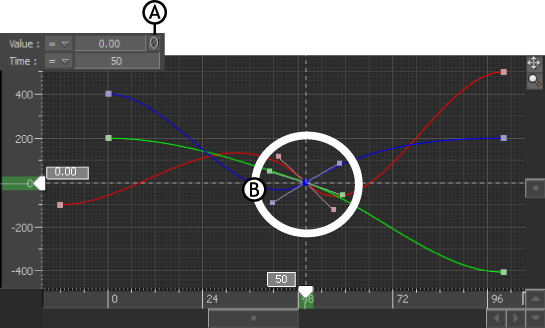

To reset the value of the keyframe to 0, you can click the Reset icon for the Value setting.
Resetting values A. Reset icon B. Keys reset to 0
