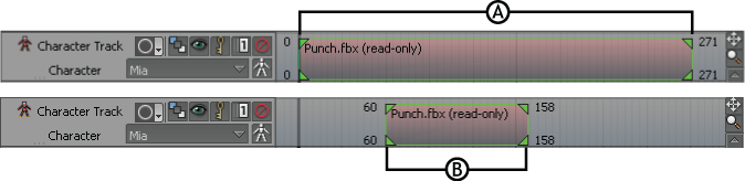

MotionBuilder differentiates between the length of a clip and the original animation data it contains. When you modify a clip, such as shortening or looping, the original length of the animation data is not lost.
Clip in Story window A. Original length of animation data from frames 0 to 271 B. Clip resized from frames 60 to 158 without losing original animation data

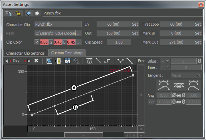

A Story clip’s TimeWarp curve indicates the full length of the animation data (A), not the current visible length of the clip. Small vertical lines (B) appear on the TimeWarp curve to indicate the start and end of the clip. Both of these lines may or may not display depending on how you have manipulated the clip.
TimeWarp for Story clip A. Original length of animation data from frames 0 to 271. B. Current start and end of clip from frames 60 to 158
