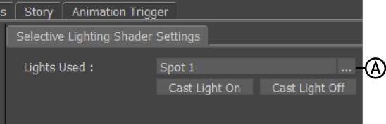

Access the Asset list through the Asset list button () that appears next to the field.
Asset Selection List A. button

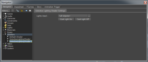

When you click the Asset list button, a list of all the corresponding assets added to your scene displays.
Assets used in the scene

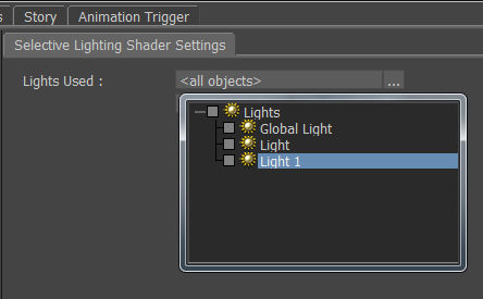

The Tree/List options let you choose which way you want to view the contents of the Asset list.
Select Tree to make the Asset list display in a tree hierarchy with check boxes that are either activated or disabled. Select List to make the Asset list for the selected objects display as a list. Unlike the Tree display, the List display only shows selected objects.
OptionBehavior
Check Whole BranchesSelect Check Whole Branches to select the item and all its child items when selecting/deselecting something in the Asset list.
Find First Checked ChildSelect Find First Checked Child if the tree hierarchy is collapsed. It expands the tree to the first selected child item.
Find Child by NameSelect Find Child by Name to open the Find Child by Name search window. Enter the name of a specific asset or object in the search window to have MotionBuilder locate it.
Expand BranchSelect Expand Branch to completely expand the branch of the item selected.
Select BranchUse the Select Branch option to select all the items included in the item’s hierarchy in the Asset list and in the Viewer window.
Select ObjectUse the Select Object option to select the object in the Asset list and in the Viewer window.

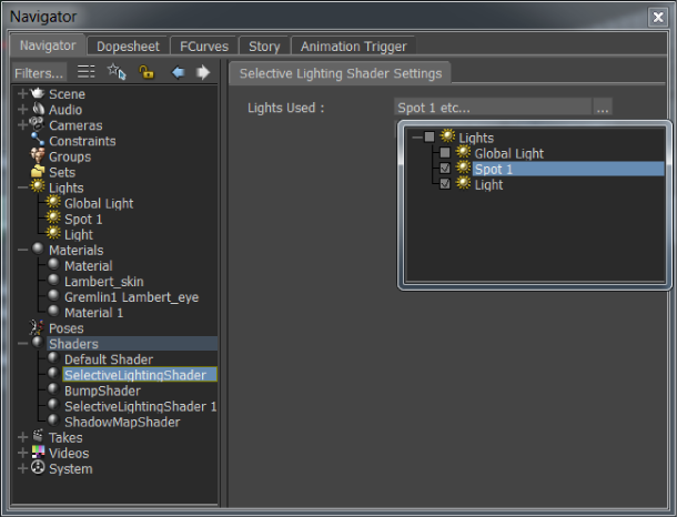

To select items from the Asset Selection list:
  1. Click the Asset List button.
    The Asset list appears with assets appropriate to the asset you are selecting. For example, if you are using the Lights Used Asset list, all the lights used in the scene are displayed.
  2. Activate the option that corresponds to each asset you want to select.
    Note:
    If you want to select all items contained in the list, activate the option next to the root folder. For example, in the preceding image, the root folder is the Lights folder.

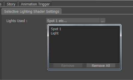

To remove items in your Asset list:
  1. Double-click the Asset field.
    A list appears with all the assets you have assigned.
  2. Select the items that you want to remove from the list.
  3. Click Remove.
