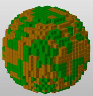

This function is similar to the chessboard function, with the difference that the blocks are assigned randomly to the resulting fragments. A threshold is used to determine the percentage of blocks assigned to the new fragment.
  1. Right-click the fragment in the project tree.
  2. Choose Randomize.
  3. Enter the Blocksize for the structure cell along the X, Y, and Z axes.
  4. If desired, specify a translation for along the X, Y, and Z axes to offset the insertion of blocks.
  5. Specify a threshold percentage of blocks to be assigned to the new fragment.
  6. Click Randomize.
