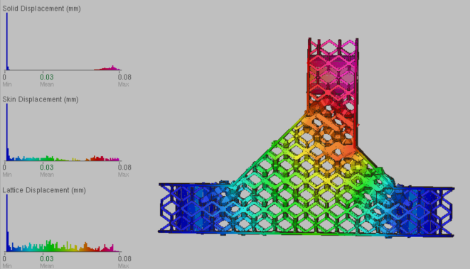

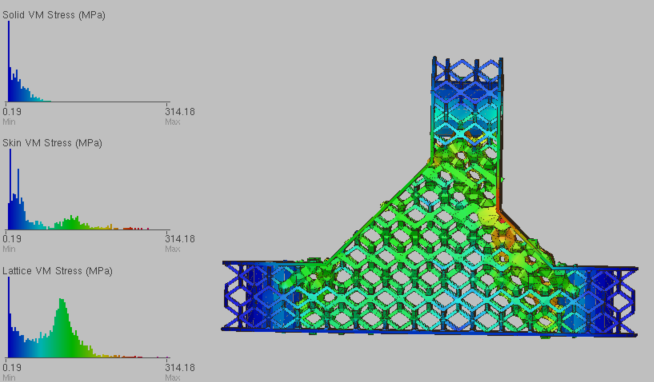

  5. Review stress and displacement results for optimization. Note where lattice bars were thickened in the optimization process.
    Optimization stress results
    Optimization displacement results
