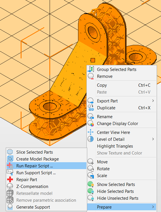

  6. In Netfabb, right-click the part and select Prepare > Run Repair Script.
  7. In the Automatic Repair dialog, select Extended Repair and click Execute.

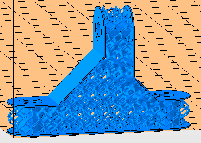

    Final repaired part
