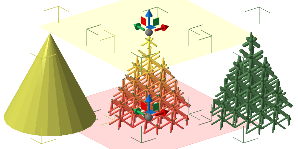

To add a thickness gradient
A thickness gradient makes beams across a span of lattice progressively thicker or thinner. You can provide XYZ coordinates for each of the beginning (highlighted with a red plane) and the end (yellow plane) of the gradient, or use the gizmos in the display.
  1. In the project tree, select one of the lattices or surface lattices of a component.
  2. In the main menu, click Apply Thickness Gradient.
  3. Adjust values as needed, including selecting the right lattice from the Target lattice dropdown.
  4. Click Generate.
Three steps of creating a thickness gradient. From left: The original body, its lattice with the gradient being set up, the finished lattice with gradient.
