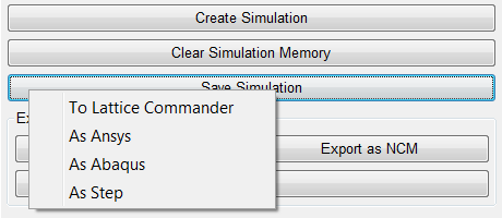

Lattice information as created through 3S can easily be transferred to the Lattice Commander, capitalizing on existing knowledge and workflow.
- Generate the Lattice topology through 3S:
- Load a part into Parts and select a topology from the Structure Library.
- Generate the topology through .
- In the part's Project Tree branch , select the desired Cell and apply it with Create Simulation.
- Transfer the generated topology through
