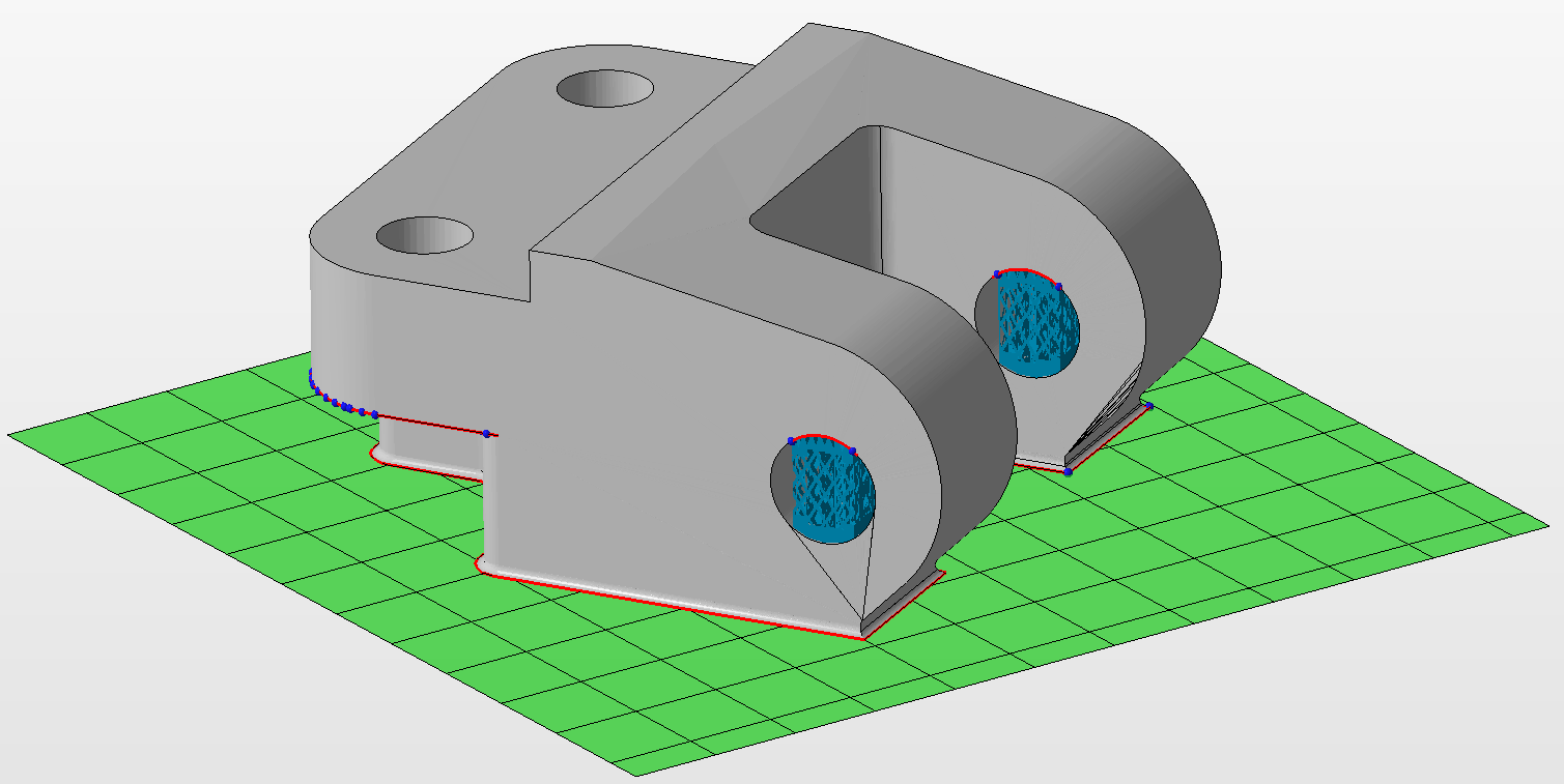

The lattice-like supports are created.
- For this exercise, we want only the back supports to be homogenized. Click each of the two curved front supports to select them, then right-click and choose
Remove selection. You may need to do this more than once if you see bits of lattice remaining.

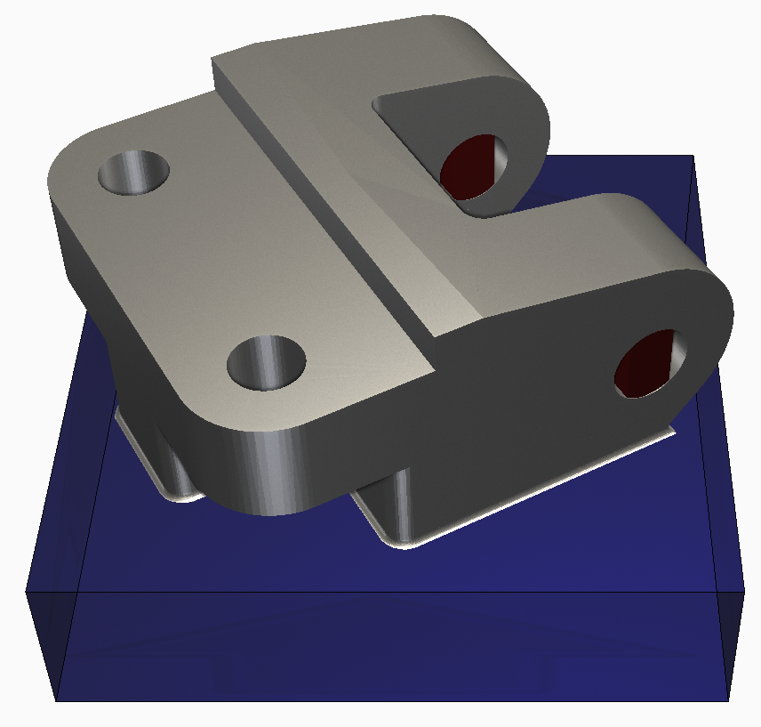

The exported file takes a minute or so to generate, then opens inside the Local Simulation window.
- If you want to reduce the size of the build plate, click .

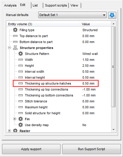

- A thickness must be added for the curved front lattice supports to mesh. Select both curved supports by holding down the Ctrl key and clicking the left mouse button.
- In the right pane, click the
Edit tab.
Expand the Structure properties menu by pressing the + symbol.
- In the
Thickening up structure-hatches field, type
0.50. This will create support structure walls approximately 2-3 bead widths wide. Click
Apply support; in the
Editor Apply Behavior dialog, click
Keep Editor.

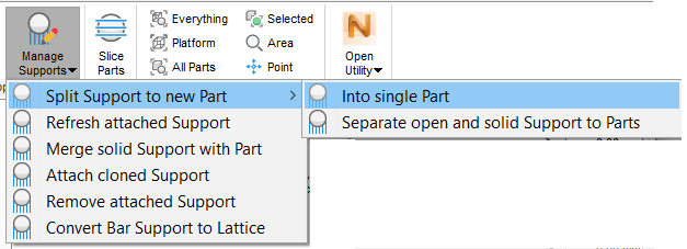

- To use in simulation, these supports must be turned into an STL file. Click
- In the project tree, you should see the new part under the Parts node, with (support) in its name. If the part does not appear, right-click .
- Right-click the support part and click . In the Export Parts dialog, beside the File Name field, click Select and navigate to the same folder where the first Example_21.3mf file was saved. Name the new file Example21_support.stl, click OK.

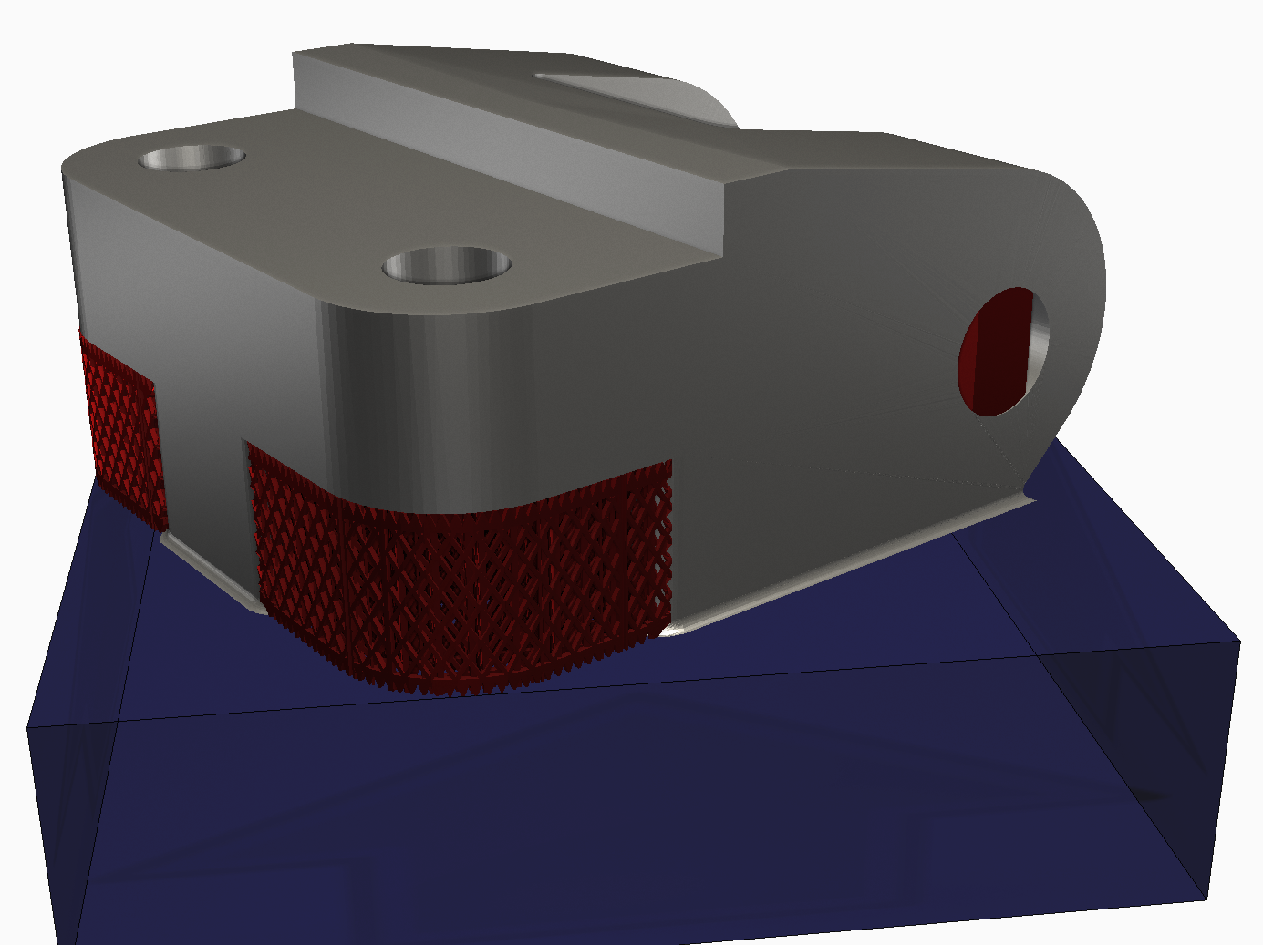

Local Simulation window. On the Home tab, click
Import. Select the
Example_21_support.stl file just created. Designate this as a
Support Structure with a
Volume Fraction of
1.00 when prompted.
Now you have a part with two types of supports, and you can proceed to perform a simulation as outlined in previous tutorials.
