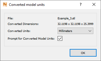

- In the
Converted model units dialog, ensure that
Converted Units are
Millimeters and then click OK.
This imports the STL file and automatically sizes the build plate:

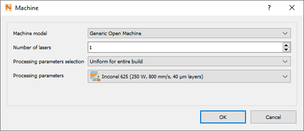

- Click
to open the
Machine dialog.
- Leave the Machine Model setting at the default Generic Open Machine.

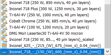

- In
Processing Parameters, select the PRM file you generated in Tutorial 2, or another one for Inconel 718.
- Click
On the Properties tab, deselect Match Part Deposition Material, and in the Material menu, select SAE 304, a stainless steel, which is commonly used with Inconel powder.

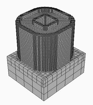

- Before attempting a full simulation, check the quality of the mesh by clicking
Mesh Preview
If you have not already saved your project, you will be asked to do so. Choose a file path that will be easy to find later. After a brief wait, the finished mesh appears.

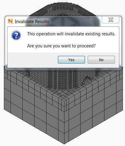

- Click
Solve
to run the simulation on your computer:
- Click Yes to invalidate (update) existing mesh results.

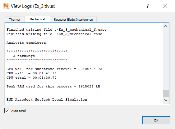

A window opens to show the solver output files in real time. Three tabs at the top, Thermal, Mechanical, and Recoater Blade Interference, report on different aspects of the simulation.
This log displays simulation status details, including the current layer group being solved, the total number of layers to be solved, number of nodes, elements, and equations for each increment, increment number, time, iterations per increment and their associated residuals.
Any warnings or errors during the simulation are displayed in this window. The end of each simulation phase log states the following details:
- "Analysis complete" message
- Total warnings recorded (if applicable)
- CPU wall time, which is the actual time required to finish the simulation
- CPU total time, which would be the time required to finish the simulation for an equivalent single core machine
It's a good practice to examine the logs at the end of every thermo-mechanical simulation; not only will they inform you about errors in the simulation, but if serious build failure mechanisms occur such as recoater blade interference or support structure failure, these will be recorded in the mechanical log file. These topics are explained in more detail in later examples.

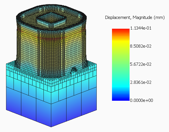

- When the simulation finishes, the results open in Local Simulation, and the Results tab opens.
- In the Browser on the left side of the window, hide the
Geometry display by clicking the light bulb next to it so it goes from on (
) to off (
). Under the
Results folder, turn on the light bulb for
Displacement results.
- Play through the results using the
Play button
or other
Animation controls, stopping on the penultimate increment of the simulation, before the build plate disappears.
By default, the legend normalizes to the current minimum and maximum result. You can click inside the legend rectangle to move or resize it. To change the legend to a horizontal or vertical bar, click and drag it out the right side or top of the window, then back in.
If your window for Local Simulation is narrow, you see a double arrow
on the far right. Click it to expand the
Results tab display.
- To make the displacement results more visible, in the
Results Display panel, select
Warp by displacement and set
Displacement scale to 5.
This warps the part by the predicted displacement and magnifies the effect 5 times, which makes it easier to observe the changes in geometry caused by thermally induced plastic distortion.
