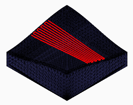

Upon import, observe the curved laser path on a double-curved substrate.

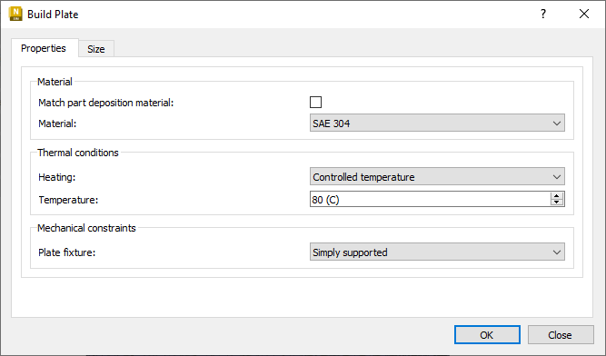

- Click
; deselect
Match part deposition material, and set
Material to SAE 304. Note that unlike standard DED simulations, with 6-axis DED simulations you can specify the substrate material.
- Also on the Properties tab, under Thermal conditions, Heating, set a Controlled temperature of 80° C, then click OK.

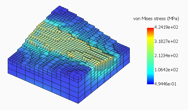

- Click , and select von Mises stress to record this stress type during simulation, then click OK.

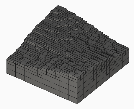

- Click
Mesh Settings, and set the values shown for
Elements per heat source radius (1),
Fine layers below heat source (3), and
Adaptivity levels (3).
- Click
Mesh Preview. If you have not already saved the project, you will be asked to do so.
- Assured the mesh looks fine, click Solve to start the simulation. This will take about an hour to run on a 4-core computer.

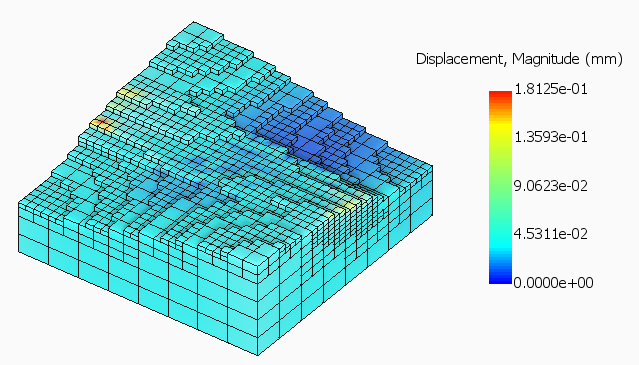

- When Results appear, examine the Displacement and von Mises stress results. Note the large number of increments in the simulation results.
