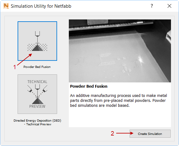

- Click .
- In the dialog that opens, click
Powder Bed Fusion and then
Create Simulation.

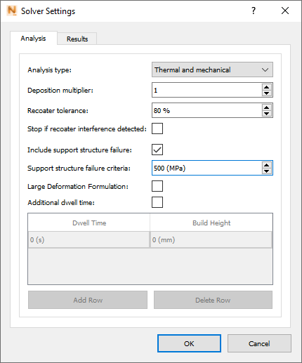

- Click
; on the
Analysis tab, select
Include support structure failure criteria, and set the failure criteria to
500 MPa.

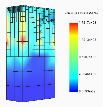

- In the Browser, ensure that the geometry is turned off, and turn on the von Mises stress results.
- Play through the animation, noting where stress appears in the geometry.

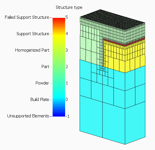

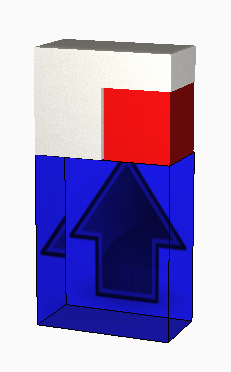

To check for support structure failure, change the results display to Structure Type. Failed support structures are colored red (5).

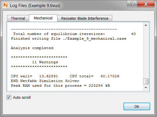

- On the Results tab, click
and scroll to the end of the log file. Here you can see the number of predicted support structure failures. By scrolling back up through the log, you can identify the exact time that each one occurred.
