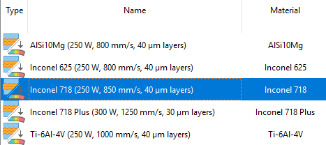

- In
Processing parameters, select the
Inconel 718 PRM file.

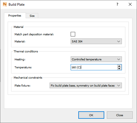

- Click
Deselect Match part deposition material, and in the Material menu, select SAE 304 stainless steel, which is commonly used with Inconel powder.
- Under Thermal conditions, Heating, select Controlled temperature.
- In the Temperature box type 160 (C).
- Click OK.

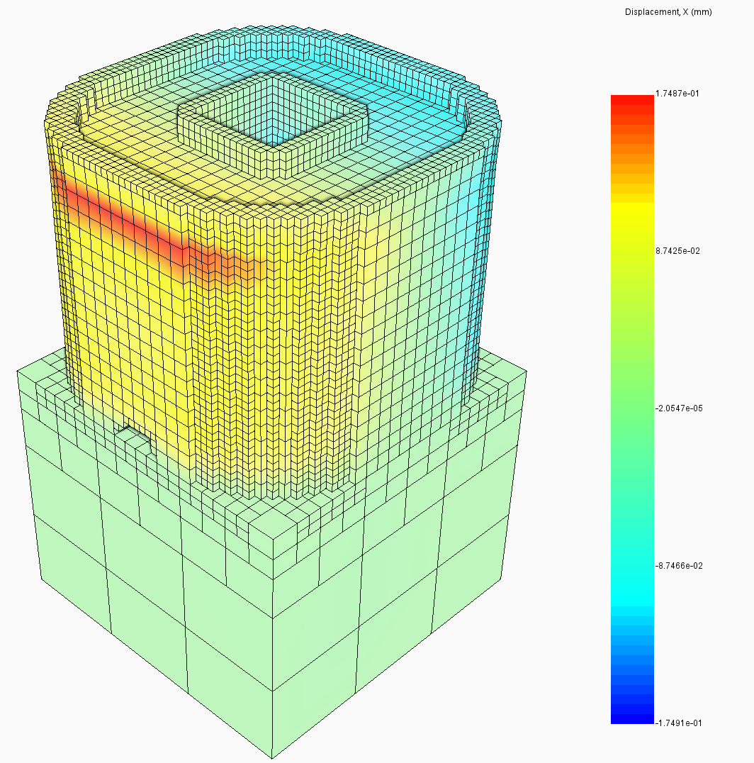

When the simulation finishes, the results are displayed and the Results tab opens.
- To compare the displacement to experimental results, in the
Results Settings panel, change the
Component value to
X.
The peak distortion predicted using the generic Inconel 718 PRM file is 0.17 mm which is much lower than the experimentally measured 0.40 mm. The model-measurement correlation can be improved by scaling the PRM file.

- Select the generic
Inconel 718 PRM file provided with
Local Simulation and click the scaling button, as shown below.

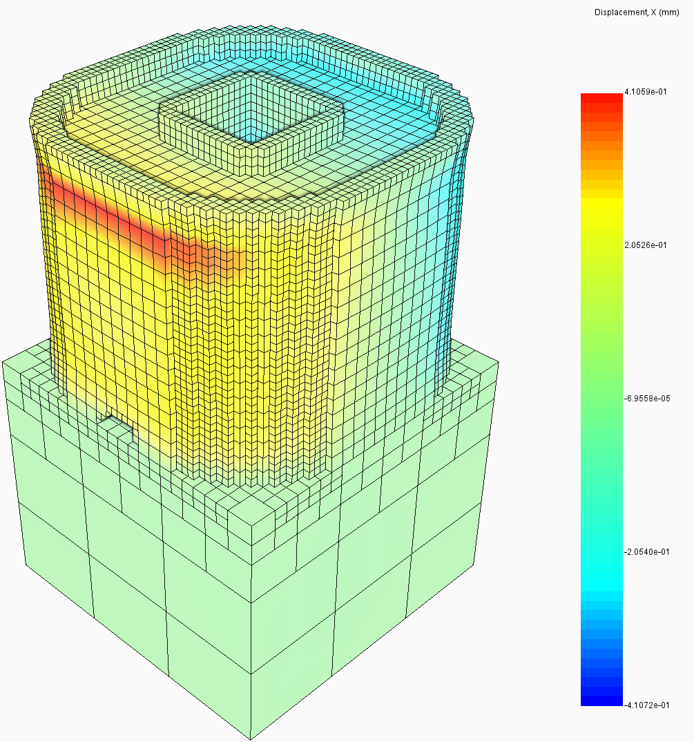

- Click Solve again. When prompted to overwrite previous results, select OK to proceed.
- The new results are loaded.
Note: To see the correct displacement results, in the Results Settings panel, set the Component value to X, as you did for the first simulation results. Check that the Results legend title is "Displacement, X (mm)" to see the correct results. If the Component field shows an X value, but the legend does not, manually change the field value to Y, then back to X.
Using the scaled PRM file attains model results within 1% of the actual measurements. This scaled PRM file can then be used to perform simulations of this material and processing parameter combination with confidence in the accuracy of the predicted distortion.
