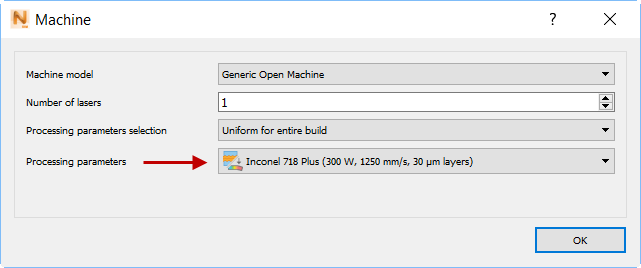

  4. On the Home tab, click Machine, and set Processing parameters to Inconel 718 Plus.

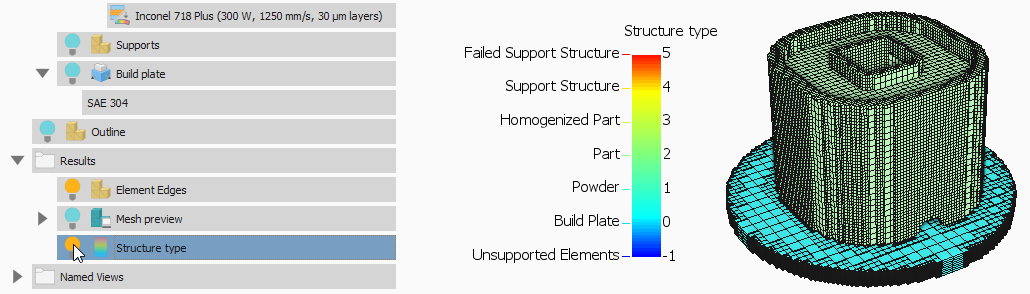

    When the mesh is displayed, you can check it for errors. In the Browser results, click the lightbulb for Structure type to see the color-coded types before the simulation.

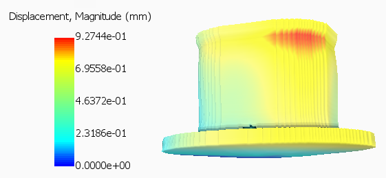

  10. Display Displacement results, then in the Results Display panel, select Warp by Displacement, and set the Scale Factor to 5.00.
    With displacement results exaggerated in this way, you should be able to see quite clearly that the thin build plate has distorted during the simulation.
