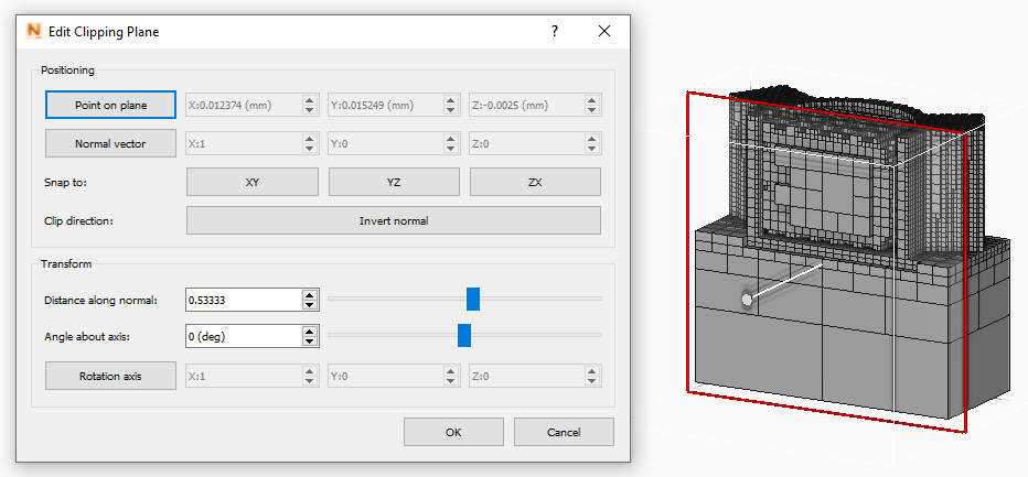

- To view the mesh in more detail, go to the
View tab and click
Clipping
. In the
Edit Clipping Plane dialog, select
Snap to YZ to orient the plane, and use the
Distance along normal slider to move the plane along the X axis. If you want to slide the plane along the Y axis, select Snap to ZX.
The irregular mesh is created because the gaps in the lattice are too large to be spanned by the default Maximum Cell Radius. The Maximum Cell Radius sets the largest gap or feature that will be filled in during Homogenization. By default, this value is 2.50 mm, meaning that lattice holes up to 5.00 mm across will be homogenized. However the features of the Lattice component in this example obviously exceed 5.00 mm. We can improve the lattice mesh by increasing the maximum cell radius setting.

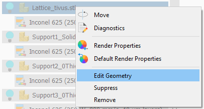

- In the Browser, right-click

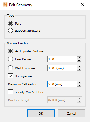

- In the Edit Geometry dialog, select
Homogenize, change
Maximum Cell Radius to
5.00 mm, and click
OK.

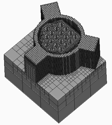

- On the Home tab, click
Mesh Preview to regenerate the mesh. You should notice that the lattice mesh is much smoother.

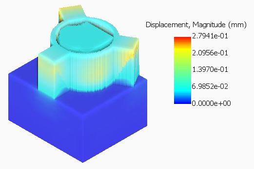

The Displacement results show that the different densities of support structures affects the part scale distortion of these parts. You can use this data to optimize support design, which can be done much more rapidly than if all the supports were modeled directly with very fine meshes.

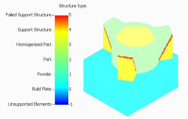

The Structure Type results show severe support structure failure. This indicates that the supports are likely too weak and should be made more dense.
