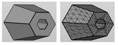

To adjust the level of detail
A reduced level of detail may be necessary for projects containing many parts or complex parts. Netfabb operations run faster when parts are displayed with lower levels of detail.
- Select a part.
- Click
and choose the appropriate level of detail.
Note: If no parts are selected, the level of detail is applied to all parts. Also, when parts are created as duplicates, they share the same level of detail. This connection can only be resolved by overwriting the duplicate, such as by applying repair to it.
Left: Part with low level of detail. Right: Part with high level of detail.
Despite the coarse appearance of low-detail parts, the part attributes remain unchanged. The project tree reports the current level of detail for each part.
Part levels of detail in the project tree
