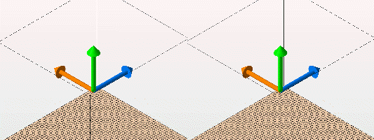

Tip: Use the O key to constrain the orbit mode: When constrained, any left-right rotation happens about a vertical axis on the platform bottom, and this axis is then only allowed to tilt straight towards or away from the camera. When unconstrained, or free, any left-right rotation happens around a vertical axis that is parallel to your display.
Free orbit (left) and constrained orbit (right)
