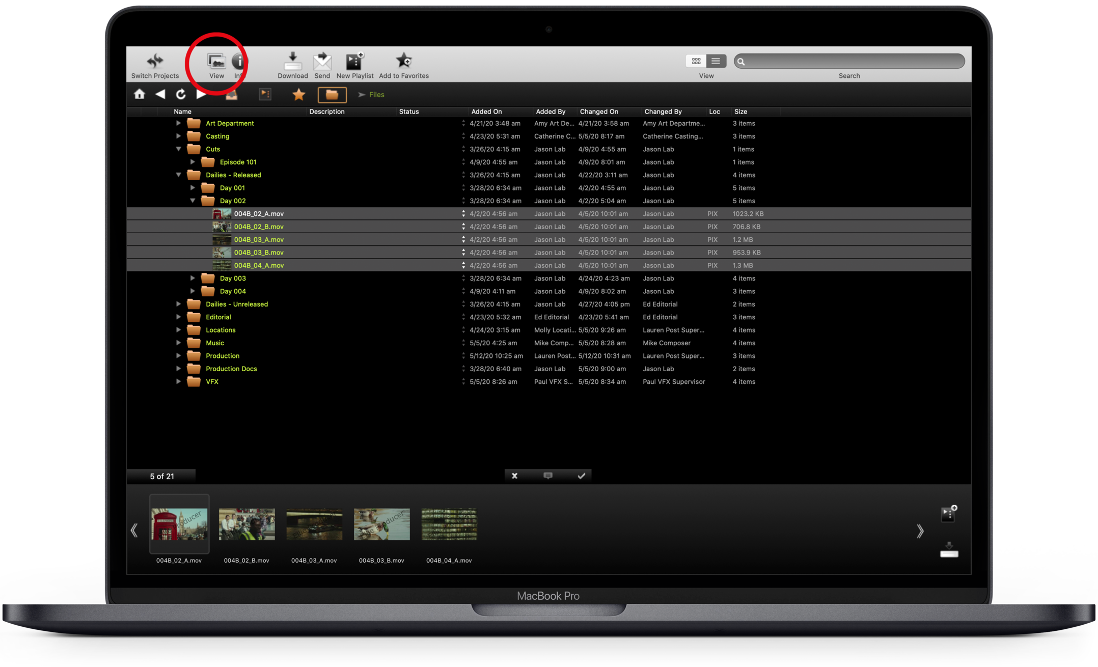

Select clips to view
Double-click the clip to open it in the viewer.
To view multiple clips, select all the items first, and then click the View button in the top toolbar.
Or, drag the clips you want to view into the bin.

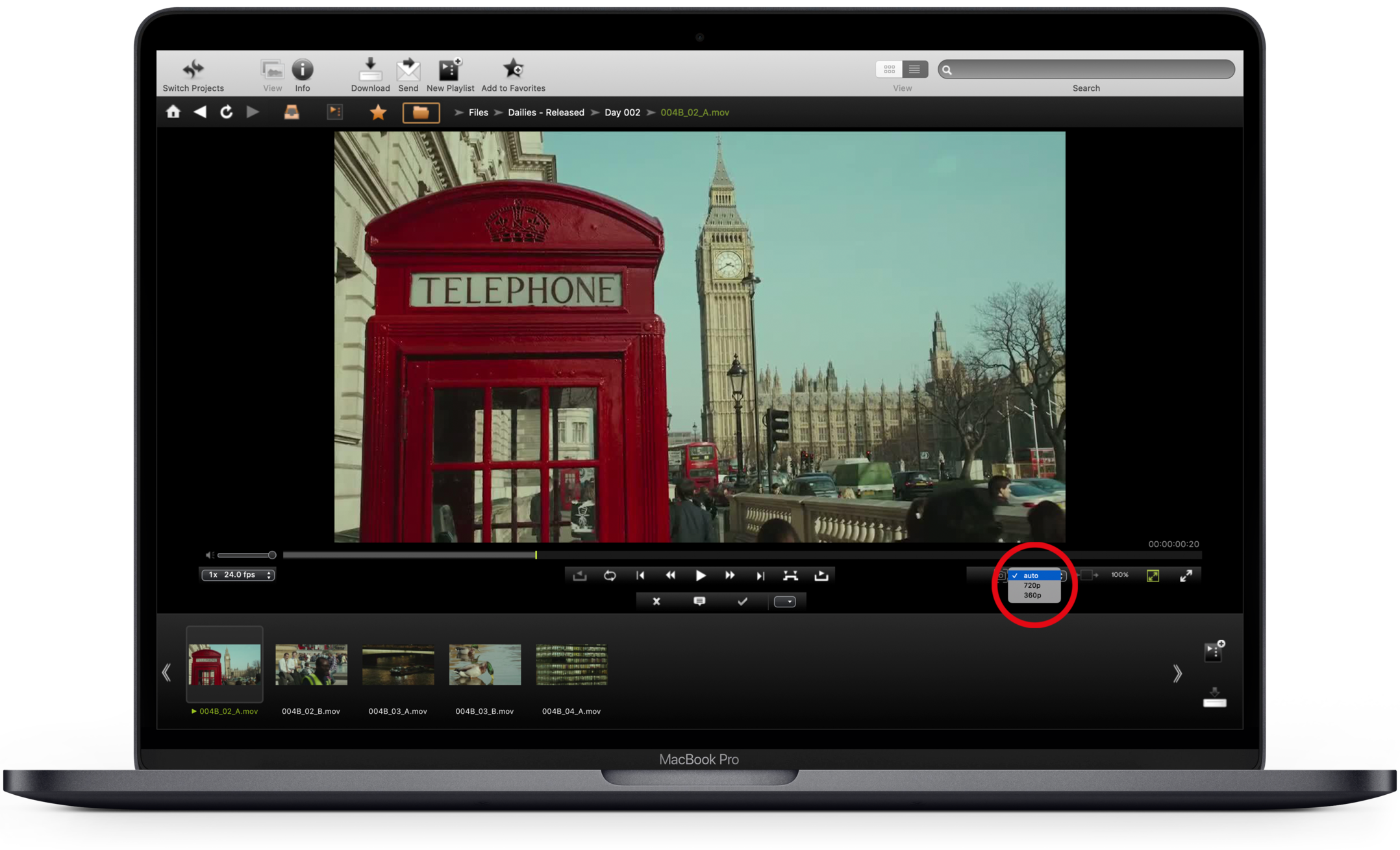

Adjust the resolution
When additional resolutions are available for a clip, you can choose to view the clip in a higher resolution, or a lower resolution for faster loading. Choose your resolution via the dropdown in the bottom right of the viewer.
*On older PIX 2 for macOS applications, the resolution dropdown choices will be reflected as SD or HD.

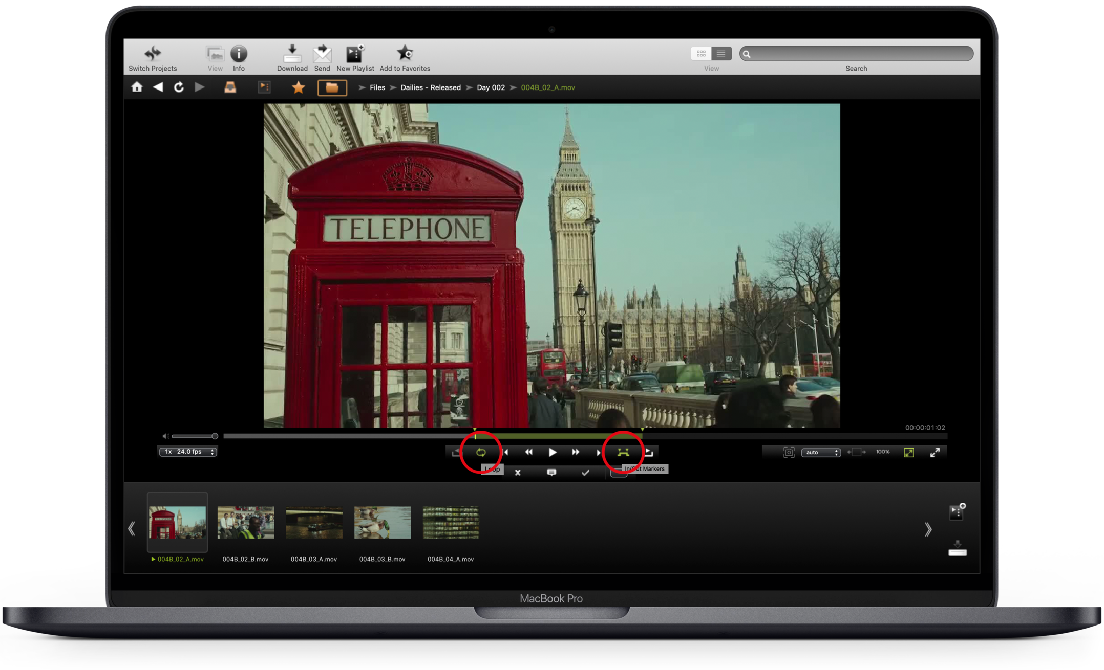

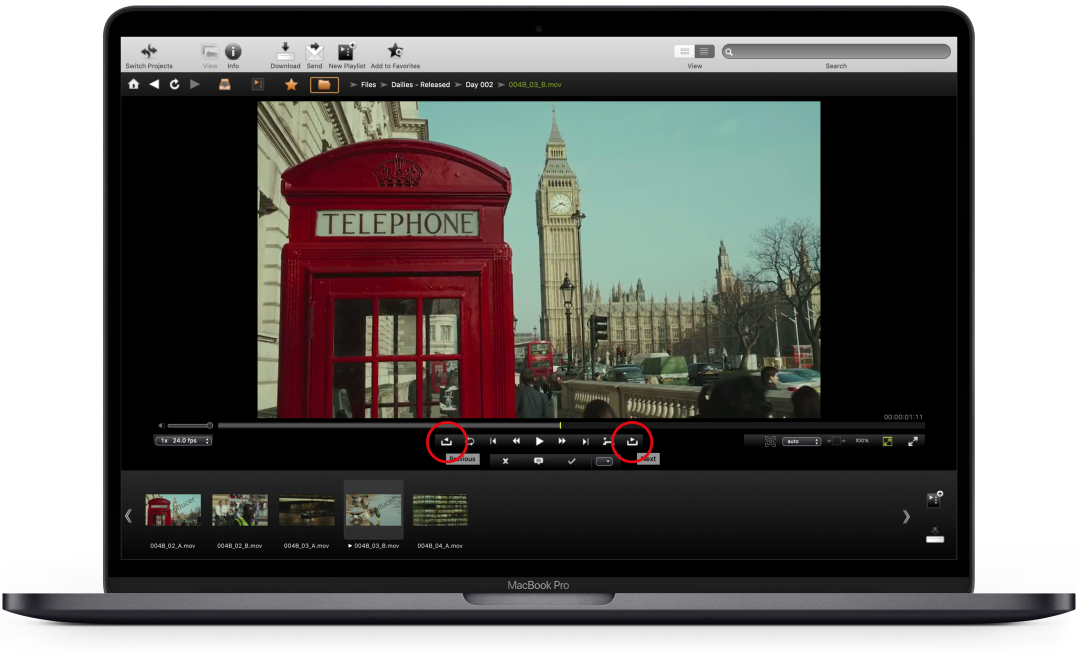

Set IN and OUT markers
To set IN and OUT markers, click the markers button in the playback controls. Move the markers by dragging either end along the timeline. Or, use the keyboard shortcuts:
| I (the letter I) | Set IN marker |
| O (the letter O) | Set OUT marker |
| Command-Shift-M | Toggle markers on and off |
Loop clips
To loop an entire clip or loop between IN and OUT markers, click the Loop button in the playback controls. Or, use the Command-Shift-L keyboard shortcut to toggle loop on and off.

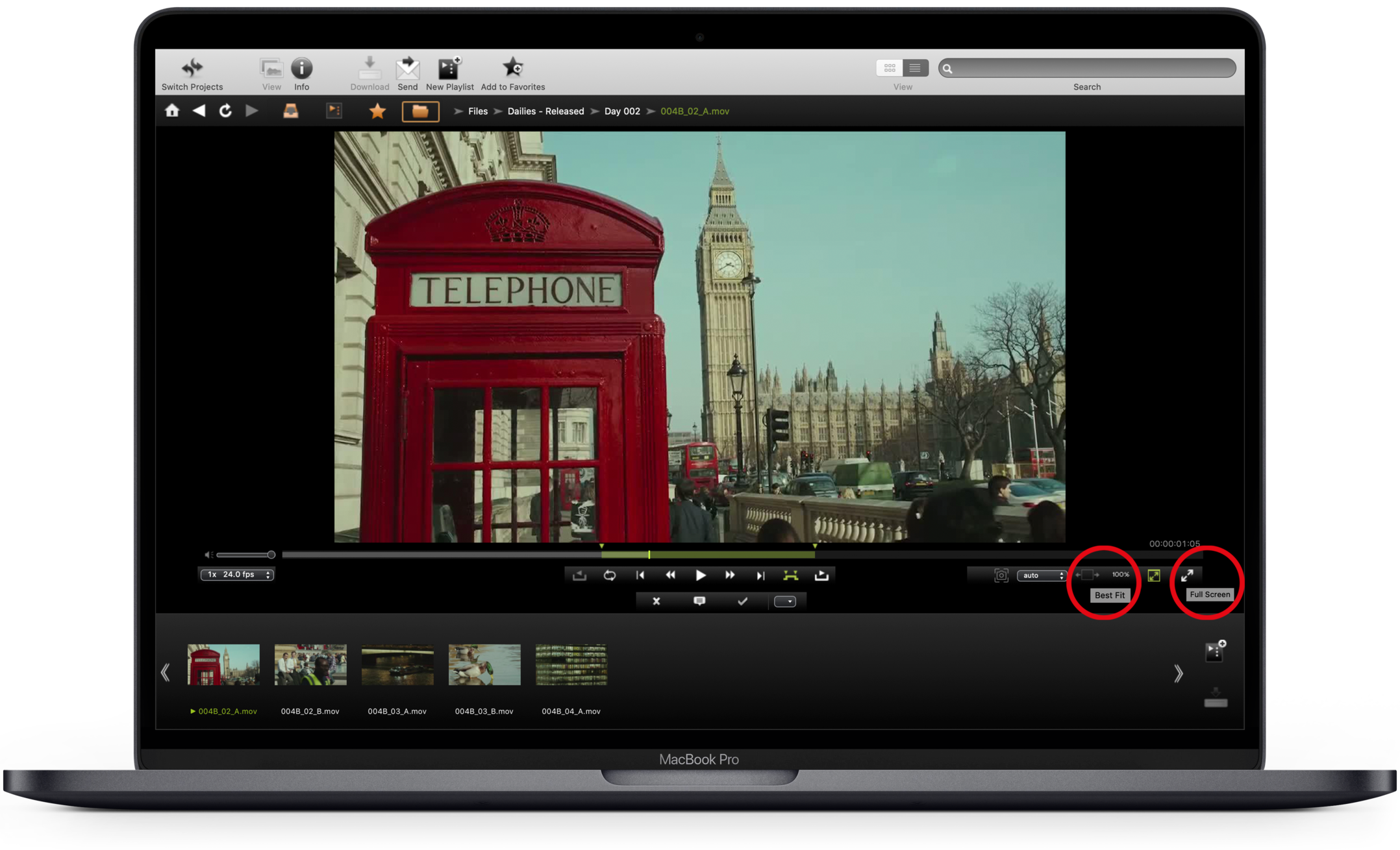

View in Full Screen
To enter fullscreen mode, click the rightmost button under the viewer. Or, use the keyboard shortcuts:
| Command-Shift-F | Enter fullscreen |
| ESC | Exit fullscreen |
Resize clips
To resize the clip, click the Best Fit button or the View at 100% button.

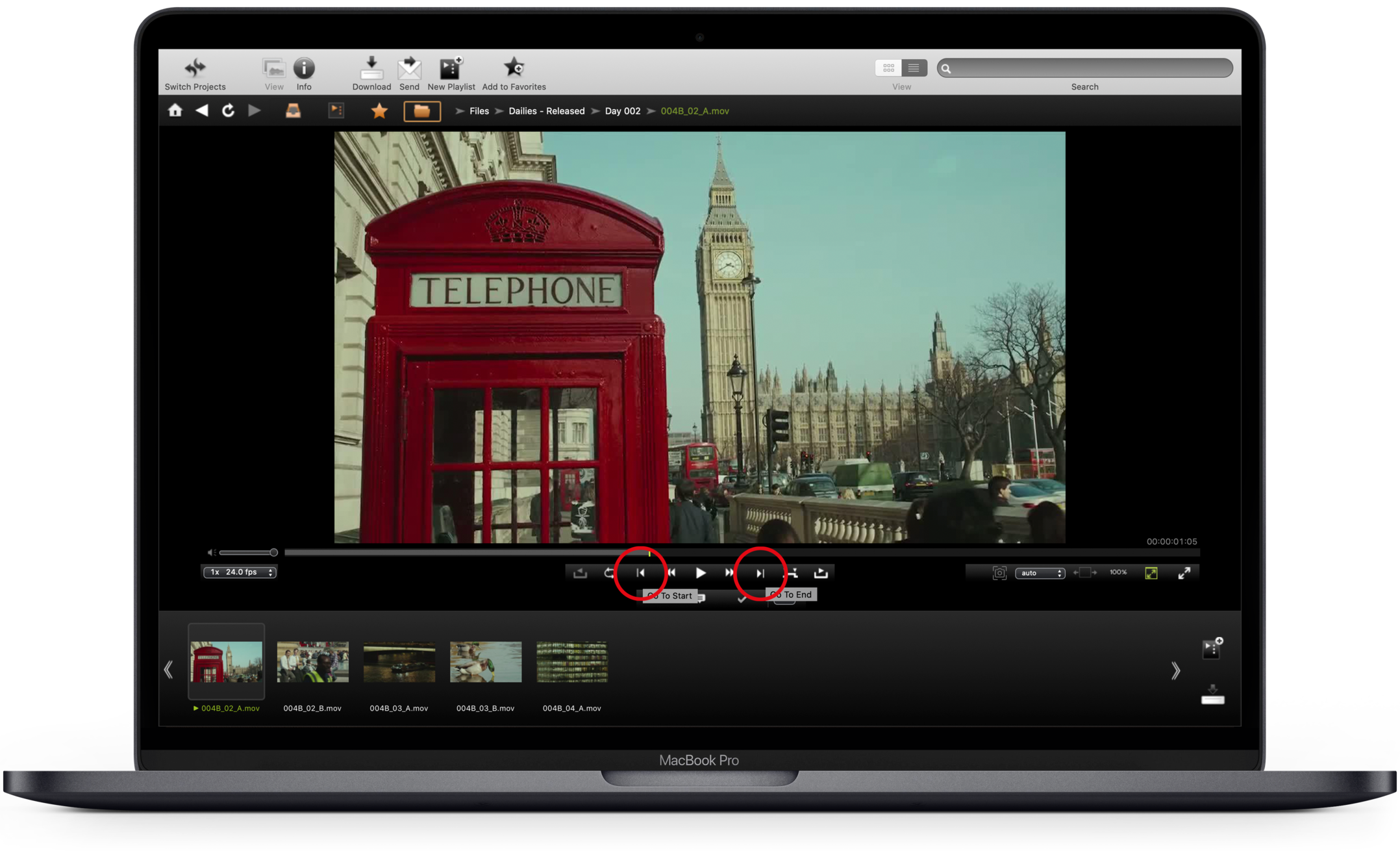

Move to the next or previous item
To move to the Previous or Next item, click Previous or Next buttons at the far ends of the playback controls. Or, use the keyboard shortcuts:
| → | Go to next item |
| ← | Go to previous item |
