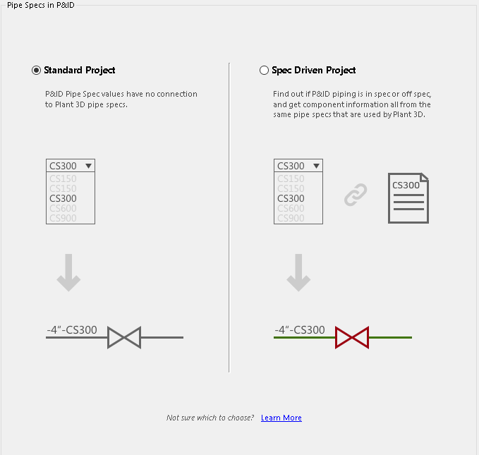

Pipe Specs in P&ID dialog box
Standard Project
Sets the project so that there is no connection between the P&ID Pipe Spec properties and Plant 3D Pipe Specs.
Spec Driven Project
Sets the project so that P&ID looks up/references the Plant 3D Spec files so that a P&ID drafter knows if objects in their P&ID are "in spec" or "out of spec".
