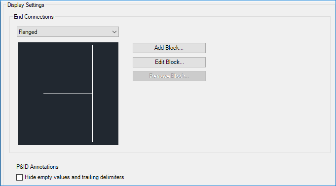

Display Settings (P&ID DWG Settings Tree Node)
Displays available end connections in a project.
End Connections
Displays the configured end connections available in a project.
End Connections List
Displays the types for the selected end connection.
Add Block
Displays the New End Connection dialog box.
Edit Block
Displays the AutoCAD Block Editor, where you can edit the assigned block for an end connection.
Remove Block
Deletes an end connection.
P&ID Annotations
Specifies the display settings for annotations.
Hide Empty Values and Trailing Delimiters
Controls the display of empty annotation placeholders and related delimiters when no value is specified.
