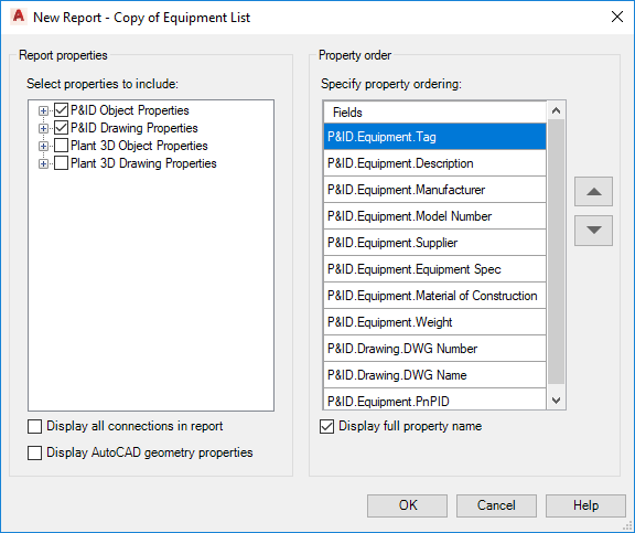

Modify Report Dialog Box
Modifies an existing report template.
Report Properties
Defines the properties for a report.
Select Properties To Include
Displays a list of properties in the existing template. Select the properties you want to retain for the modified template.
Display All Connections In Report
When this checkbox is selected, multiple valve tags (one for each connected line number) are displayed. By default the box is clear.
Display AutoCAD Geometry Properties
Displays or hides AutoCAD geometry properties.
Property Order
Defines the properties order for a report.
Specify Property Ordering
Displays a list of properties for the properties selected in the left pane. You can use the Up or Down arrows to order the properties.
Display Full Property Name
Displays or hides the full property name.
