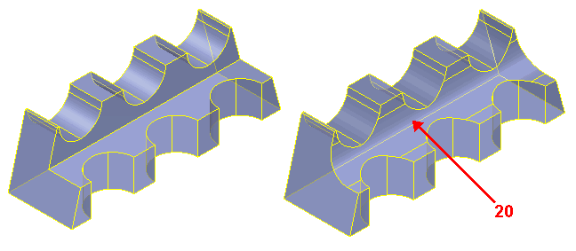

In this model, a fillet of 20 is added. The cut-outs intersect with the fillet, maintaining the fillet curvature throughout.

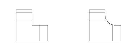

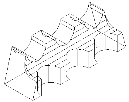

Looking at the wireframe view below, you can see that the fillet is carried right up the side walls of the block.
