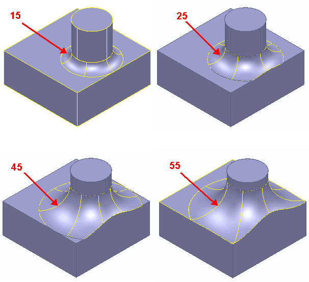

Example 6 - Flexibility of the 'Rolling ball' technique
This example illustrates the flexibility that the 'rolling ball' technique provides.
Each of the models below shows the effect of a different radius. The numbers in red are the radius of the fillet that was used to produce the model. Note how the edge of the block is modified so that the filleting is smooth at the intersection between the block and the fillet.
