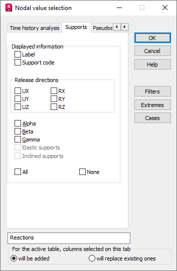

Select the Supports tab in the Nodal Value Selection dialog to select support parameters for presentation.
Values for the following parameters are selected in the Displayed Information dialog:
- Label - adds a column for a name of the support,
- Support code - adds a column for the support (schematic representation of released and blocked directions for the support),
- Release direction - the directions of the support releases for the given support type; selecting one of the directions adds a column for the release or blocking of the directions in a given node,
- Alpha - adds a column for the Alpha angle (the inclination of support in relation to the Z axis),
- Beta - adds a column for the Beta angle (the inclination of support in relation to the Y axis),
- Gamma - adds a column for the Gamma angle (the inclination of support in relation to the X axis),
- Elastic support - adds a column for the elastic supports defined in the structure,
- Inclined supports - adds a column for the inclined supports defined in the structure.
When the dialog is opened from the Supports table, the following options are available.
- List of edges - adds a column for edges on which a given support has been defined
- List of objects - adds a column for panels on which a given support has been defined.
Note: If the dialog is opened directly from the support table, then additional support properties will be provided.
