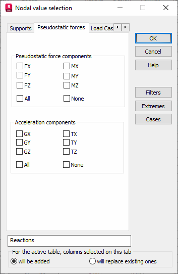

Select the Pseudostatic Forces tab in the Nodal Value Selection dialog to select the following pseudostatic force components for presentation.
- FX, FY, FZ - If selected, they add table columns for FX, FY or FZ pseudostatic forces, respectively, obtained during structure analysis (forces given in the local bar coordinates system).
- MX, MY, MZ - If selected, they add table columns for MX, MY or MZ pseudostatic moments, respectively, obtained during structure analysis (forces given in the local bar coordinates system).
