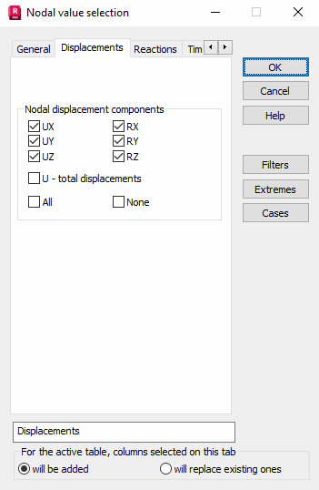

Select the Displacements tab from the Nodal Value Selection dialog to modify node displacement components for presentation.
You can select the following nodal displacement components.
- RX, RY, RZ - If selected, they add table columns to display structure node rotations about the X-axis, Y-axis or Z-axis, respectively, of the global coordinate system (obtained during structure analysis).
- UX, UY, UZ - If selected, they add table columns to display node displacements in the direction of X-axis, Y-axis or Z-axis, respectively, (global bar coordinate system).
- Total resultant displacement in the global system whose value equals the root of the sum of squares of the displacements UX, UY, UZ.
