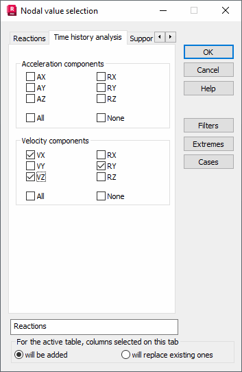

Select the Time history analysis tab in the Columns dialog for the presentation of nodal quantities.
Time history analysis, apart from the main load case, creates two auxiliary load cases containing the top (+) and bottom (-) envelope. Selecting the main load case displays the results for components of the complex case.
Select the components of velocity and acceleration of displacements for the case of time history analysis. (tables of structure nodes).
