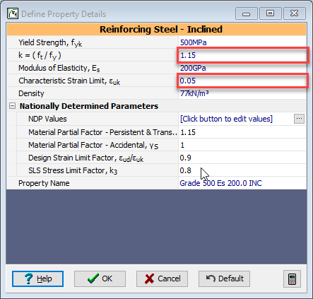

  6. Next, click on the Reinforcing Steel material and set the value of k to “1.15” and the Characteristic Strain Limit to “0.05”.
  7. Click ✓ OK to close the form.

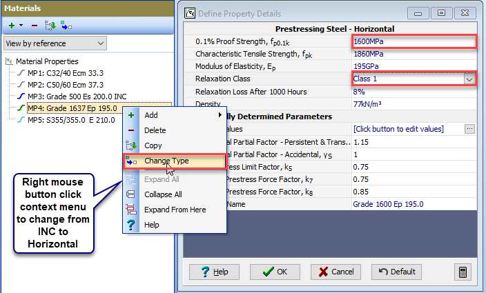

  8. Finally, click on the Prestressing Steel material and then right mouse button click to Change Type to “Prestressing steel – Horizontal”.
  9. Ensure that the 0.1% Proof Strength is set to “1600MPa” and the relaxation class is set to “Class 1” before closing the form with ✓ OK.
    Proof Strength Proof Strength
  10. Save the file as “My EU Example 10_1 Materials.sst”.
