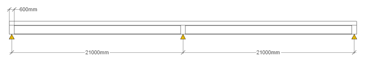

This two span bridge deck is constructed of Y beams (6 in each span with the outer beams being YE beams) acting compositely with a 200mm thick concrete slab.
Two Span Bridge Deck
600mm wide diaphragms are cast to the bottom of the beams along the three lines of support and bearings are placed under the ends of the beams. There is a small 300mm deep upstand at the edge of the slab.
Two Span Bridge Deck Two Span Bridge Deck

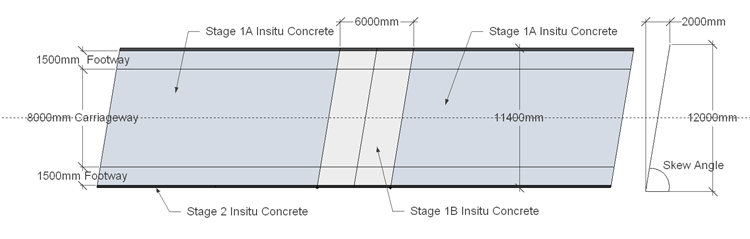

Both spans are 21m from support centre lines which are slightly skewed as shown below.

The construction sequence is firstly to place the beams onto supports so that they carry their own weight. The insitu slab (excluding the edge upstand) is then cast for the first 18m of each span, measured from the free ends, leaving a 6m infill over the central row of supports (the end diaphragms are cast as part of stage 1A). The next stage is to cast the 6m infill slab with the central diaphragm, which, when hardened will make the beams continuous over the central supports. Lastly the upstand is cast.

The carriageway is 18m wide with a 1.5m footway on either side.
