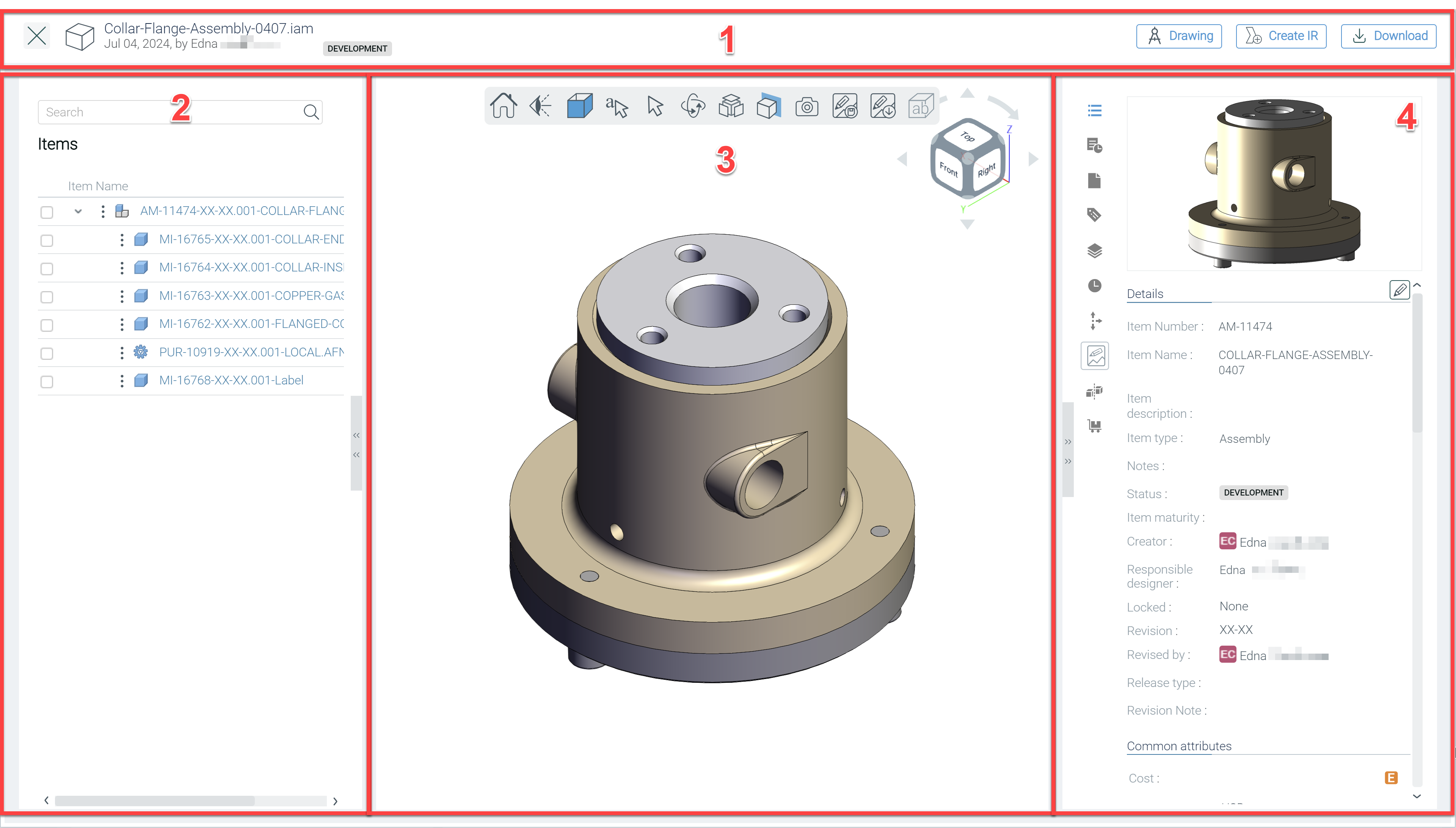

3D viewer interface overview
The 3D viewer interface is divided into:
  1. Header - View information about the opened item. You can also download CAD files for the opened model, download a PDF translation of its associated drawing, or create an Investigation request (IR) from here.
  2. Left pane - View the item's bill of materials. Click an item to open its details in the right detail view and to highlight it in the main pane.
  3. Main pane - View the 3D model, DIE, or weldment, and perform additional actions on it.
  4. Right pane - View more details about the opened item including its attributes, attached documents, associated activities, CAD attributes, CAD file history, saved markups, and item compares.
    Note: This pane only shows details of the parent item loaded into the 3D viewer.
Tip: Use the arrows along the left and right pane to collapse or expand them as desired.
