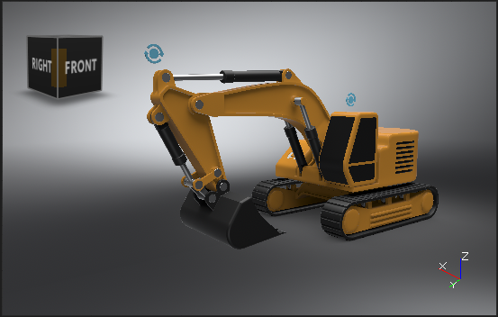

  • Show Volume Visualizations - Displays a representation of the volumes in the Render View.
