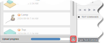

  6. Optional: To see the Job Status dialog, at the bottom right of the Fusion window, click View Job Status view job status icon.
    job progress
