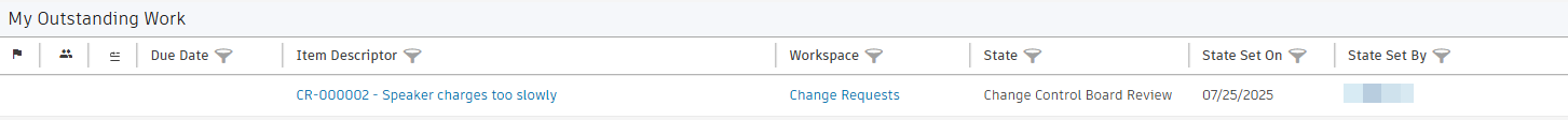

  1. Review the change request.
    1. Locate the change request in your My Outstanding Work list.
      change request CCB review My Outstanding Work

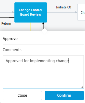

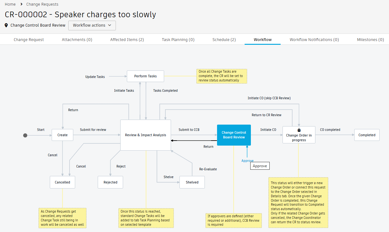

  2. Approve the change request and generate a change order.
    • Option 1: From the Workflow tab, click the Initiate CO transition.
    • Option 2: From the Workflow Actions drop-down, select Initiate CO.
      Add a comment, then click Confirm.
      change request CCB review approve workflow action
      CCB review approved confirm
      A change order is generated and a link to it is placed in the Related Processes section and Schedule tab. The change request is moved to the Change Order in progress state. It will remain in this state until the change order is approved.
      The system also copies the details from the change request to the change order, including the selected change template, affected items, and attachments.
      On the change request, your name is added to the Approved By field in the Change Control Board Review section.
      The change request remains locked in the Change Order in progress state until the related change order is completed, which you will do in the next tutorial. Once the change order is complete, the system automatically completes the change request and if applicable, the related problem report.
