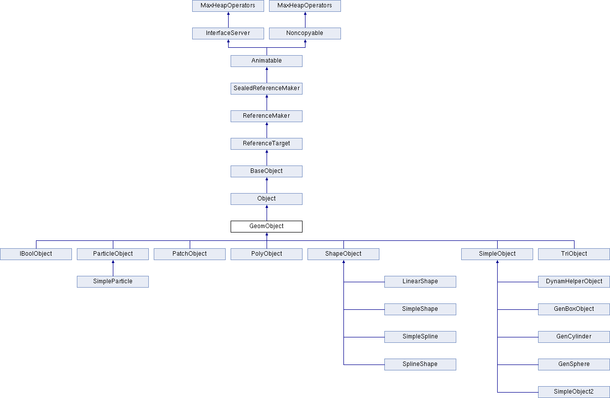

Inheritance diagram for GeomObject:Public Member Functions | |

Implements Object.
Reimplemented in ShapeObject, SimpleParticle, SplineShape, SimpleSpline, SimpleShape, and SimpleObject.
inlinevirtual |
Retrieves a constant representing the type of the plugin.
Reimplemented from ReferenceTarget.
Reimplemented in ShapeObject.
inlinevirtual |
Indicates whether the object may be rendered.
Some objects such as construction grids and helpers should not be rendered and can return zero.
Implements Object.
inlinevirtual |
If an object creates different meshes depending on the particular instance (view-dependent) it should return nonzero; otherwise 0.
Reimplemented in PatchObject.
virtual |
This method should be implemented by all renderable GeomObjects.
It provides a mesh representation of the object for use by the renderer. Primitives that already have a mesh cached can just return a pointer to it (and set needDelete to FALSE). Implementations of this method which take a long time should periodically call View::CheckForRenderAbort() to see if the user has canceled the render. If canceled, the function can either return NULL, or return a non null pointer with the appropriate value for needDelete. (If needDelete is TRUE a non-null mesh will be deleted.)
| t | The time to get the mesh. |
| inode | The node in the scene. |
| view | If the renderer calls this method it will pass the view information here. See Class View. |
| needDelete | Set to TRUE if the renderer should delete the mesh, FALSE otherwise. |
Reimplemented in ShapeObject, PatchObject, PolyObject, TriObject, and SimpleObject.
inlinevirtual |
Objects may supply multiple render meshes ( e.g.
particle systems). If this method returns a positive number, then GetMultipleRenderMesh and GetMultipleRenderMeshTM will be called for each mesh, instead of calling GetRenderMesh.
inlinevirtual |
For multiple render meshes, this method must be implemented.
set needDelete to TRUE if the render should delete the mesh, FALSE otherwise.
| t | The time at which to obtain the mesh. |
| inode | The pointer to the node. |
| view | A reference to the view. |
| needDelete | TRUE if the mesh needs to be deleted, otherwise FALSE. |
| meshNumber | Specifies which of the multiplie meshes is being asked for. |
inlinevirtual |
| meshTM | Should be returned with the transform defining the offset of the particular mesh in object space. |
| meshTMValid | Should contain the validity interval of meshTM. |
virtual |
This method provides a patch mesh representation of the object for use by the renderer.
If this method returns NULL, then GetRenderMesh() will be called.
| t | The time to get the patch mesh. |
| needDelete | Set to TRUE if the renderer should delete the patch mesh, FALSE otherwise. |
virtual |
This method allows objects to specify the class that is the best class to convert to when the user collapses the stack.
The main base classes have default implementations. For example, GeomObject specifies TriObjects as its preferred collapse type and shapes specify splines as their preferred collapse type
Reimplemented from Object.
inlinevirtual |
Returns TRUE if this object can do displacement mapping; otherwise FALSE.
Reimplemented in PolyObject, and TriObject.
