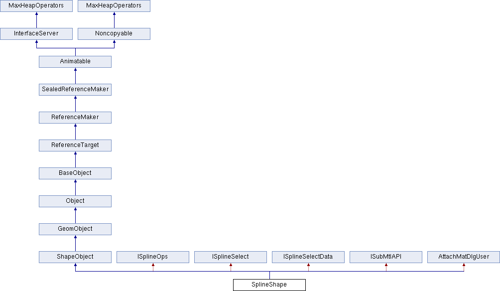

Inheritance diagram for SplineShape:Public Member Functions | |
