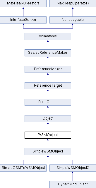

| SClass_ID | SuperClassID () |
| | Implemented by the System. More...
| virtual Modifier * | CreateWSMMod (INode *node)=0 |
| | When the user binds a node to a space warp, a new modifier must be created and added to the node's WSM derived object. More...
| virtual int | UsesWireColor () |
| | This is a method of Object. More...
| virtual BOOL | NormalAlignVector (TimeValue t, Point3 &pt, Point3 &norm) |
| virtual BOOL | SupportsDynamics () |
| | Returns TRUE if spacewarp or collision object supports Dynamics; otherwise FALSE. More...
| virtual ForceField * | GetForceField (INode *node) |
| | Returns a pointer to a ForceField. More...
| virtual CollisionObject * | GetCollisionObject (INode *node) |
| | This method returns the collision object for the WSM. More...
| CoreExport void * | GetInterface (ULONG id) |
| | Inherited from Animatable. More...
| CoreExport | Object () |
| CoreExport | ~Object () |
| virtual int | IsRenderable ()=0 |
| | Indicates whether the object may be rendered. More...
| virtual void | InitNodeName (MSTR &s)=0 |
| | This is the default name of the node when it is created. More...
| virtual int | DoOwnSelectHilite () |
| | If an object wants to draw itself in the 3D viewports in its selected state in some custom manner this method should return nonzero. More...
| virtual int | IntersectRay (TimeValue t, Ray &r, float &at, Point3 &norm) |
| | This method is called to compute the intersection point and surface normal at this intersection point of the ray passed and the object. More...
| void | LockObject () |
| void | UnlockObject () |
| int | IsObjectLocked () |
| virtual ObjectState | Eval (TimeValue t)=0 |
| | This method is called to evaluate the object and return the result as an ObjectState. More...
| void | LockChannels (ChannelMask channels) |
| void | UnlockChannels (ChannelMask channels) |
| ChannelMask | GetChannelLocks () |
| void | SetChannelLocks (ChannelMask channels) |
| ChannelMask | GetChannelLocks (ChannelMask m) |
| virtual BOOL | CanCacheObject () |
| | This method determines if this object can have channels cached. More...
| virtual void | WSStateInvalidate () |
| | This is called by a node when the node's world space state has become invalid. More...
| virtual BOOL | IsWorldSpaceObject () |
| | Returns TRUE if the object as a world space object; otherwise FALSE. More...
| CoreExport INode * | GetWorldSpaceObjectNode () |
| virtual BOOL | IsParticleSystem () |
| CoreExport void | CopyChannelLocks (Object *obj, ChannelMask needChannels) |
| virtual void | TopologyChanged () |
| virtual int | IsDeformable () |
| | Indicates whether this object is deformable. More...
| virtual int | NumPoints () |
| | The points of a deformable object are accessed through a virtual array interface. More...
| virtual Point3 | GetPoint (int i) |
| virtual void | SetPoint (int i, const Point3 &p) |
| virtual BOOL | IsPointSelected (int i) |
| | Returns TRUE if the 'i-th' point is selected; otherwise FALSE. More...
| virtual float | PointSelection (int i) |
| | Returns a floating point weighted point selection if the object supports it. More...
| virtual BOOL | HasWeights () |
| | Returns TRUE if the object has weights for its points that can be set; otherwise FALSE. More...
| virtual double | GetWeight (int i) |
| | Returns the weight of the specified point of the object. More...
| virtual void | SetWeight (int i, const double w) |
| | Sets the weight of the specified point. More...
| virtual BOOL | PolygonCount (TimeValue t, int &numFaces, int &numVerts) |
| | Retreives the number of faces and vertices of the polyginal mesh representation of this object. More...
| virtual void | PointsWereChanged () |
| | Informs the object that its points have been deformed, so it can invalidate its cache. More...
| virtual CoreExport void | Deform (Deformer *defProc, int useSel=0) |
| | This is the method used to deform the object with a deformer. More...
| virtual CoreExport void | GetDeformBBox (TimeValue t, Box3 &box, Matrix3 *tm=NULL, BOOL useSel=FALSE) |
| | This method computes the bounding box in the objects local coordinates or the optional space defined by tm. More...
| virtual int | IsMappable () |
| | This method lets you know if the ApplyUVWMap() method is available for this object. More...
| virtual int | NumMapChannels () |
| | Returns the maximum number of channels supported by this type of object. More...
| virtual int | NumMapsUsed () |
| | Returns the number of maps currently used by this object. More...
| virtual void | ApplyUVWMap (int type, float utile, float vtile, float wtile, int uflip, int vflip, int wflip, int cap, const Matrix3 &tm, int channel=1) |
| | This method may be called to map the object with UVW mapping coordinates. More...
| virtual CoreExport int | CanConvertToType (Class_ID obtype) |
| | Indicates whether the object can be converted to the specified type. More...
| virtual CoreExport Object * | ConvertToType (TimeValue t, Class_ID obtype) |
| | This method converts this object to the type specified and returns a pointer it. More...
| virtual Class_ID | PreferredCollapseType () |
| | This method allows objects to specify the class that is the best class to convert to when the user collapses the stack. More...
| virtual CoreExport void | GetCollapseTypes (Tab< Class_ID > &clist, Tab< MSTR * > &nlist) |
| | When the user clicks on the Edit Stack button in the modify branch a list of 'Convert To:' types is presented. More...
| virtual Object * | CollapseObject () |
| | This method is called on the world space cache object when the stack gets collapsed, that lets the pipeline object decide, if it wants to return a different object than itself. More...
| virtual DWORD | GetSubselState () |
| | For objects that have sub selection levels, this method returns the current selection level of the object. More...
| virtual void | SetSubSelState (DWORD s) |
| CoreExport void | ReadyChannelsForMod (ChannelMask channels) |
| virtual CoreExport Interval | ChannelValidity (TimeValue t, int nchan) |
| | Retrieve the current validity interval for the nchan channel of the object. More...
| virtual CoreExport void | SetChannelValidity (int nchan, Interval v) |
| | Sets the validity interval of the specified channel. More...
| virtual CoreExport void | InvalidateChannels (ChannelMask channels) |
| | This method invalidates the intervals for the given channel mask. More...
| virtual CoreExport Interval | ObjectValidity (TimeValue t) |
| | This method returns the validity interval of the object as a whole at the specified time. More...
| virtual Object * | MakeShallowCopy (ChannelMask channels) |
| | This method must make a copy of its "shell" and then shallow copy (see below) only the specified channels. More...
| virtual CoreExport void | ShallowCopy (Object *fromOb, ChannelMask channels) |
| | This method copies the specified channels from the fromOb to this and copies the validity intervals. More...
| virtual CoreExport void | FreeChannels (ChannelMask channels) |
| | This method deletes the memory associated with the specified channels and set the intervals associated with the channels to invalid (empty). More...
| virtual CoreExport void | NewAndCopyChannels (ChannelMask channels) |
| | This method replaces the locked channels with newly allocated copies. More...
| virtual CoreExport void | MaybeEnlargeViewportRect (GraphicsWindow *gw, Rect &rect) |
| | This method allows the object to enlarge its viewport rectangle, if it wants to. More...
| CoreExport bool | IsBaseClassOwnedChannel (int nchan) |
| CoreExport void | UpdateValidity (int nchan, Interval v) |
| | When a modifier is applied to an object, it needs to include its own validity interval in the interval of the object. More...
| Interval | GetNoEvalInterval () |
| void | SetNoEvalInterval (Interval iv) |
| virtual CoreExport void | ReduceCaches (TimeValue t) |
| | This method give the object the chance to reduce its caches. More...
| virtual int | IsConstObject () |
| | This is called to determine if this is a construction object or not. More...
| virtual int | NumPipeBranches (bool selected=true) |
| | This method returns the number of pipeline branches combined by the object. More...
| virtual Object * | GetPipeBranch (int i, bool selected=true) |
| | Retrieves sub-object branches from an object that supports branching. More...
| virtual INode * | GetBranchINode (TimeValue t, INode *node, int i, bool selected=true) |
| | When an object has sub-object branches, it is likely that the sub-objects are transformed relative to the object. More...
| virtual int | NumberOfContainedShapes () |
| | Returns the number of shapes contained inside this object. More...
| virtual ShapeObject * | GetContainedShape (TimeValue t, int index) |
| | This method returns the ShapeObject specified by the index passed at the time specified. More...
| virtual void | GetContainedShapeMatrix (TimeValue t, int index, Matrix3 &mat) |
| | Returns the matrix associated with the shape whose index is passed. More...
| virtual BitArray | ContainedShapeSelectionArray () |
| | This is used by the lofter. More...
| virtual BOOL | IsShapeObject () |
| virtual BOOL | CheckObjectIntegrity () |
| | This method is used for debugging only. More...
| virtual BOOL | HasUVW () |
| | It is called to find out if the object is has UVW coordinates. More...
| virtual BOOL | HasUVW (int mapChannel) |
| | It is called to find out if the object is has UVW coordinates for the specified mapping channel. More...
| virtual Object * | FindBaseObject () |
| | It is called to return a pointer to the base object (an object that is not a derived object). More...
| virtual BOOL | IsParamSurface () |
| | There are several methods used to access a parametric position on the surface of the object. More...
| virtual int | NumSurfaces (TimeValue t) |
| | Returns the number of parametric surfaces within the object. More...
| virtual Point3 | GetSurfacePoint (TimeValue t, float u, float v, Interval &iv) |
| | This method needs to be implemented if Object::IsParamSurface() returns TRUE. More...
| virtual Point3 | GetSurfacePoint (TimeValue t, int surface, float u, float v, Interval &iv) |
| | This method is used to retrieve a point on the specified surface of the object based on two parameters of the surface, u and v. More...
| virtual void | SurfaceClosed (TimeValue t, int surface, BOOL &uClosed, BOOL &vClosed) |
| | This method allows the object to return flags that indicate whether the parametric surface is closed in the U and V dimensions. More...
| virtual BOOL | GetExtendedProperties (TimeValue t, MSTR &prop1Label, MSTR &prop1Data, MSTR &prop2Label, MSTR &prop2Data) |
| | This method allows an object to return extended Properties fields. More...
