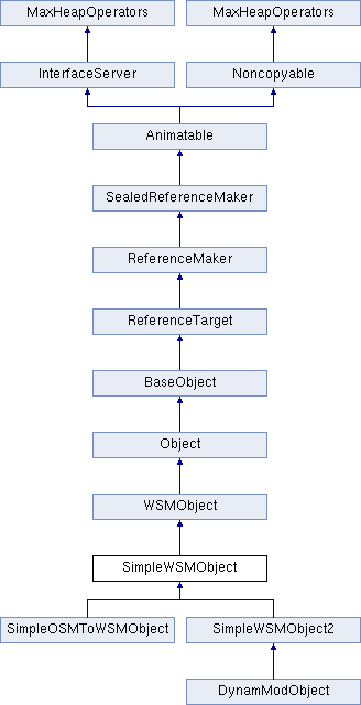

Inheritance diagram for SimpleWSMObject:Public Member Functions | |
