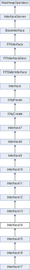

Related help topics: #include <maxapi.h>
Extends Interface13 Client code should retrieve this interface using GetCOREInterface14.
Inheritance diagram for Interface14:Public Member Functions | |
