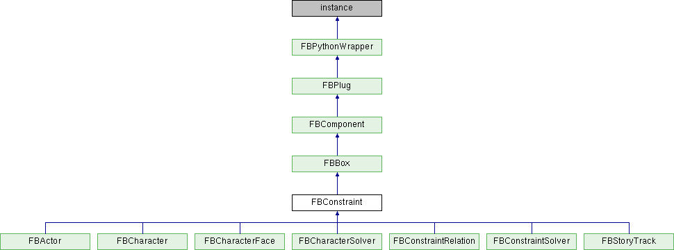

Inheritance diagram for FBConstraint:Public Member Functions | |
