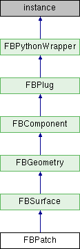

Patch class.
Inheritance diagram for FBPatch:Public Member Functions | |
