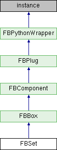

Inheritance diagram for FBSet:Public Member Functions | |
