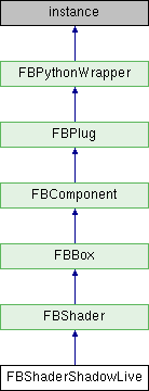

+ Inheritance diagram for FBShaderShadowLive:
