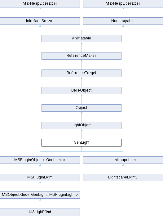

Inheritance diagram for GenLight:

Detailed Description
See also
Class LightObject, Class NameTab, Class Control, Class Interval, Class Point3, Class ObjLightDesc.
Description:
This class describes a generic light object. It is used as a base class for creating plug-in lights. Methods of this class are used to get and set properties of the light. All methods of this class are virtual.
Member Function Documentation
