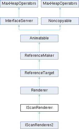

IScanRenderer Class Referenceabstract
This class provides an interface into the standard 3ds Max scanline renderer. More...
#include <C:/adskgit/3dsmax/3dsmax/3dswin/src/maxsdk/include/Rendering/IScanRenderer.h>
Inheritance diagram for IScanRenderer:
