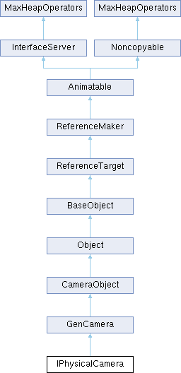

Inheritance diagram for IPhysicalCamera:
