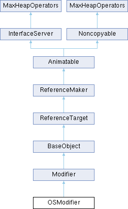

3ds Max C++ API Reference
This is a base class developers creating object space modifiers may derives their plug-ins from. More...
#include <C:/adskgit/3dsmax/3dsmax/3dswin/src/maxsdk/include/object.h>
It simply provides a default implementation of SuperClassID().
